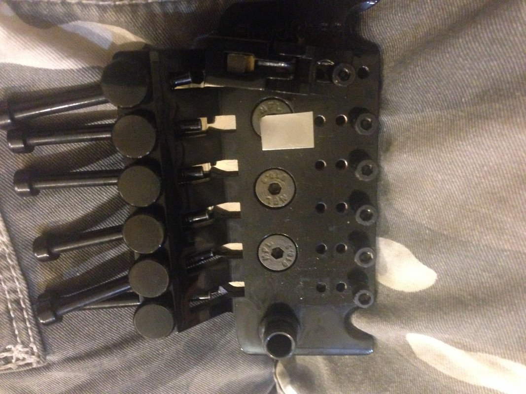

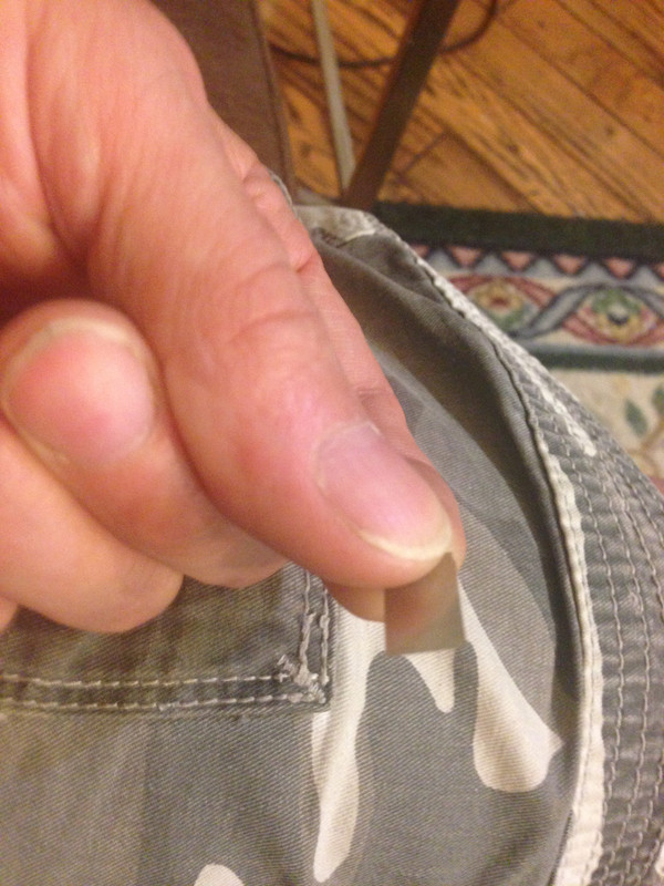

Well after a little time with my new Kiesel guitar I've found something I'm not happy about.

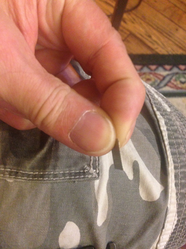

On the Floyd Rose bridge and under the "A" string saddle I found a little piece of .004 shim stock which was only behind the saddle lockdown bolt so it wasn't supporting the saddle from front to back...
AND why was it necessary to make it and put it under one saddle?

Floyds do not come in all radius configurations. It is usually put there to match the neck radius. Perfectly normal practice if done correctly. Weather or not that is proper i do not know.

trying to raise one saddle .004 doesn't change the radius configuration and it is def a hand made shim...
I'd say it seems like a quick fix for something?
I measured the saddle height against it's counterpart on the other side using a digital caliper and they are both the same height?
I just bought a new $2,000.00 guitar and there should be no "quick fix" anywhere with it, Is that unreasonable to expect???
If there is a prob with the bridge they should have used a diff one or if there is a prob with the nut they should have used a diff nut OR a much scarier thought is there a prob with the neck???
It has to be one of those three things, So which one is it???

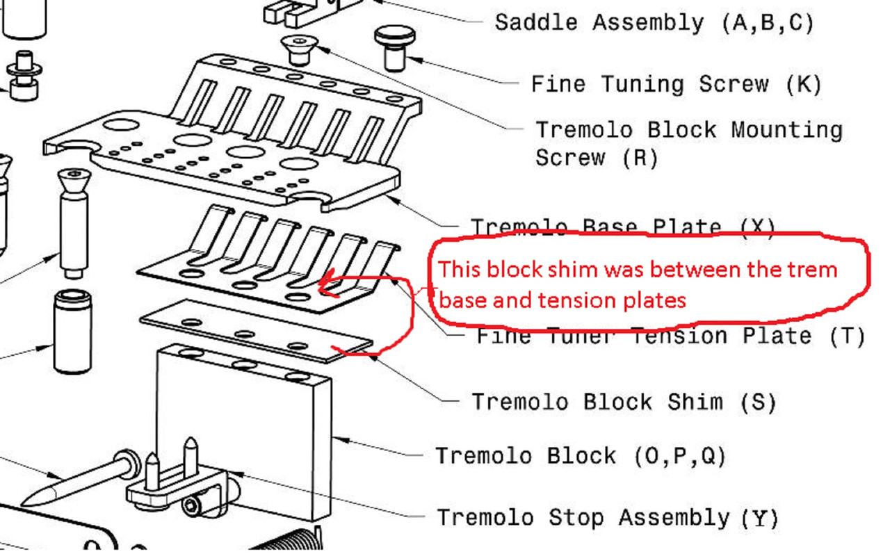

it is shimmed like the center illustration...

Another thing I found that was wrong was the shim for the saddle tension plate was between the tension plate and the base plate when it should be between the spring block and the tension plate to support the 6 fingers...

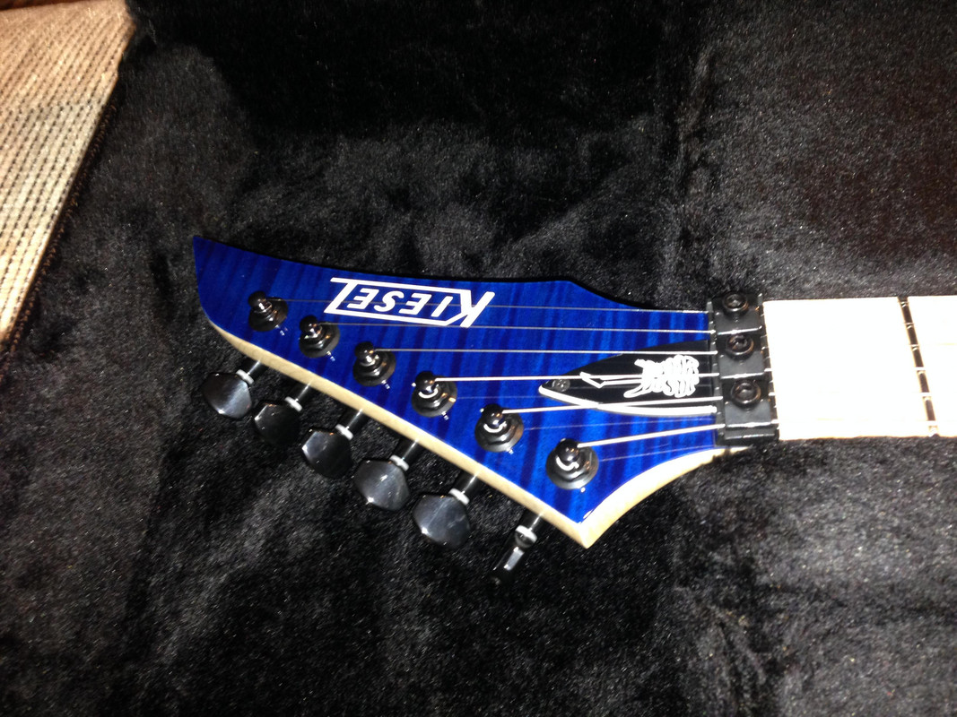

And now I see something else is wrong, I paid for the "drop shadow logo in silver" and I got plain white...

The existence of the shim doesn't surprise me. The manufacturing tolerances of the saddle blocks plus the electroplating, .0004 is nothing. That's about the diameter of a single red blood cell. Even if you meant .004, that wouldn't surprise me. To me, shims and Floyds go together like tires/wheels and wheel weights.
I'm not sure why a standard .005" Floyd shim wouldn't have worked or been used. That does seem odd.
Years ago, I remember reading something about someone putting the block shim above the base plate, but for the life of me, i can't remember why...but he had a reason. I don't actually know if Kiesel does this all the time, or even just ever...
The logo, though, is definitely a miss, and worth bringing to their attention. if the rest of the guitar is great, though, they might offer a (small) discount for you to keep it. Sometimes people fall in love with their happy little accidents. Just like my parents did. :lol:

The last thing I want is to be the "difficult" guy but I don't like the all-white logo at all, That's why I paid for the drop shadow in silver...
If you don't like it, send it back and have them fix it. They'll do it on their dime (shipping). You paid for drop shadow, you should get drop shadow.
When it's all said and done, I'm sure you'll be very pleased with your new guitar.
BTW, you are not being difficult. You're being reasonable, and I'm sure they will be as well.

As far as the logo goes, I'd just ask for your $30 back. It seems a little bit ridiculous to return the guitar and wait another 8-10 weeks for a replacement over an omission that you didn't even notice.
