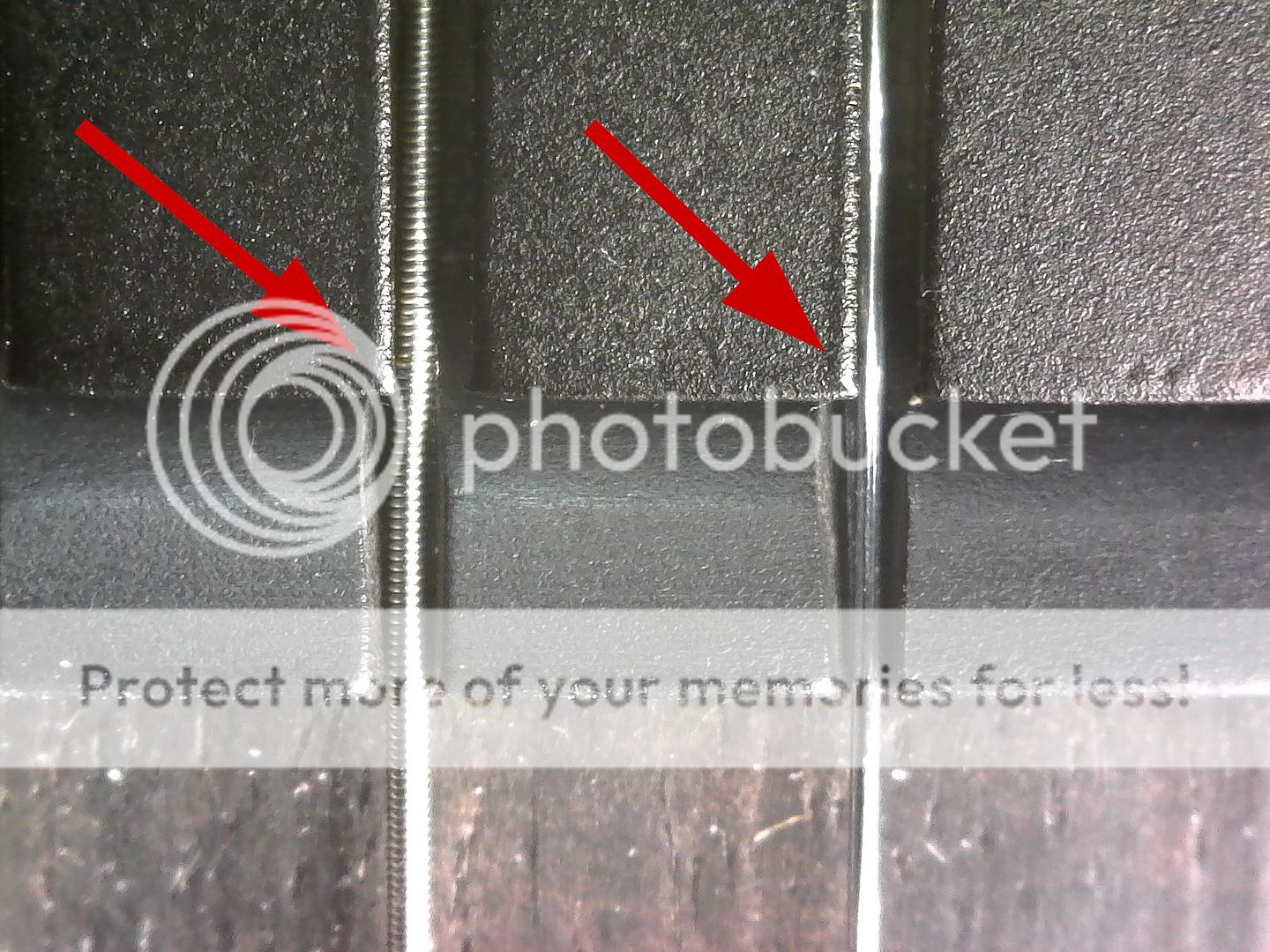

Mine is so bad that it goes out of tune when I bend strings. Dipping the bar slightly after it goes out of tune returns everything back to normal. However, sometimes it just goes out really bad when I'm playing chords, then it will eventually go back in tune after playing for a while. Really frustrating. Kiesel received my guitar yesterday. I'll post what they do to fix it, maybe that will help get yours working better.
I will say that the first time I sent the guitar back they changed bridge studs. That helped some, but it's still not usable. When they changed it out they put a rounded slot stud on the treble side of the bridge (same one used on the bass side) when before it was a v-shaped slot. Hipshot told me it should be v-shaped. I did notice that the nail points move up and down on this rounded stud when I use the bar.
Also, my nut slots aren't cut inline with the headpiece slots (the piece that locks the strings down). You can see the strings binding. They inspected it and I guess deemed it as ok because they didn't adjust it. Image attached.
